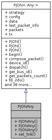

+ Inheritance diagram for PJONAny:

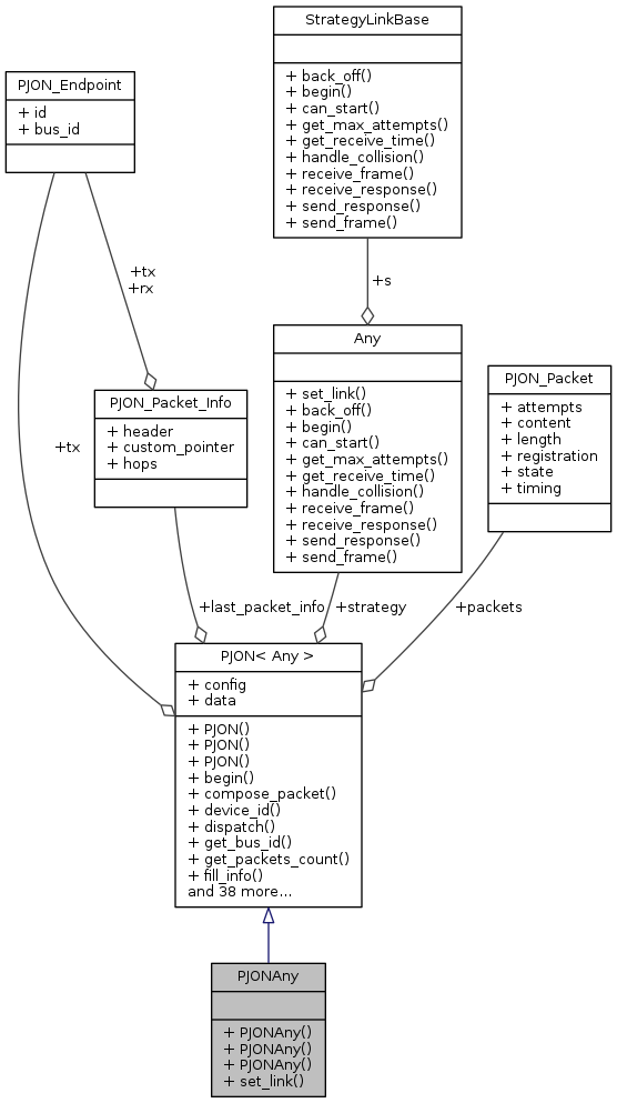

+ Collaboration diagram for PJONAny:
