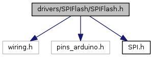

#include <wiring.h>
#include "pins_arduino.h"
+ Include dependency graph for SPIFlash.h:
