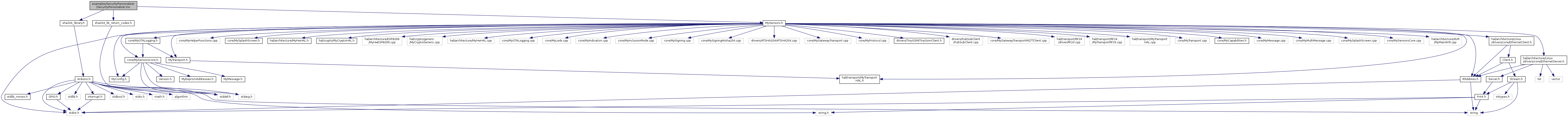

+ Include dependency graph for SecurityPersonalizer.ino:
