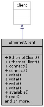

+ Inheritance diagram for EthernetClient:
