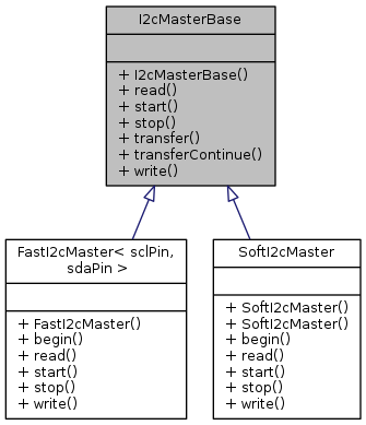

I2cMasterBase Class Referenceabstract
Base class for FastI2cMaster, SoftI2cMaster.
Definition at line 62 of file SoftI2cMaster.h.
#include <SoftI2cMaster.h>
+ Inheritance diagram for I2cMasterBase:
+ Collaboration diagram for I2cMasterBase:
