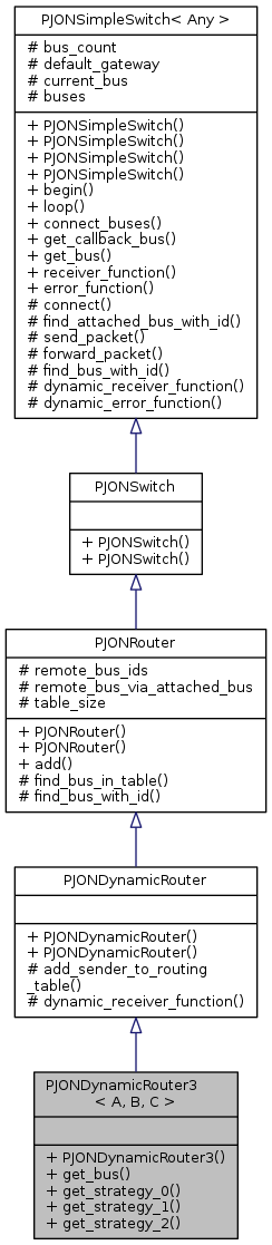

+ Inheritance diagram for PJONDynamicRouter3< A, B, C >:

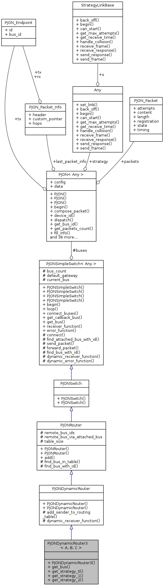

+ Collaboration diagram for PJONDynamicRouter3< A, B, C >:

- Public Member Functions inherited from PJONDynamicRouter
 PJONDynamicRouter (uint8_t bus_count, PJONAny *const buses[], uint8_t default_gateway=PJON_NOT_ASSIGNED)
- Public Member Functions inherited from PJONRouter
 PJONRouter (uint8_t bus_count, PJONAny *const buses[], uint8_t default_gateway=PJON_NOT_ASSIGNED)
void add (const uint8_t bus_id[], uint8_t via_attached_bus)
void begin ()
void loop ()
Additional Inherited Members
- Protected Member Functions inherited from PJONDynamicRouter
void add_sender_to_routing_table (const PJON_Packet_Info &packet_info, uint8_t sender_bus)
- Protected Member Functions inherited from PJONRouter
uint8_t find_bus_in_table (const uint8_t *bus_id, const uint8_t, uint8_t &start_bus)
virtual uint8_t find_bus_with_id (const uint8_t *bus_id, const uint8_t device_id, uint8_t &start_bus)
- Protected Attributes inherited from PJONRouter
uint8_t remote_bus_ids [PJON_ROUTER_TABLE_SIZE][4]
uint8_t remote_bus_via_attached_bus [PJON_ROUTER_TABLE_SIZE]
uint8_t table_size = 0
uint8_t bus_count
uint8_t current_bus
