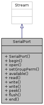

+ Inheritance diagram for SerialPort:
+ Collaboration diagram for SerialPort:
