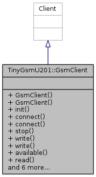

+ Inheritance diagram for TinyGsmU201::GsmClient:

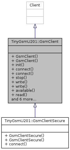

+ Collaboration diagram for TinyGsmU201::GsmClient:
