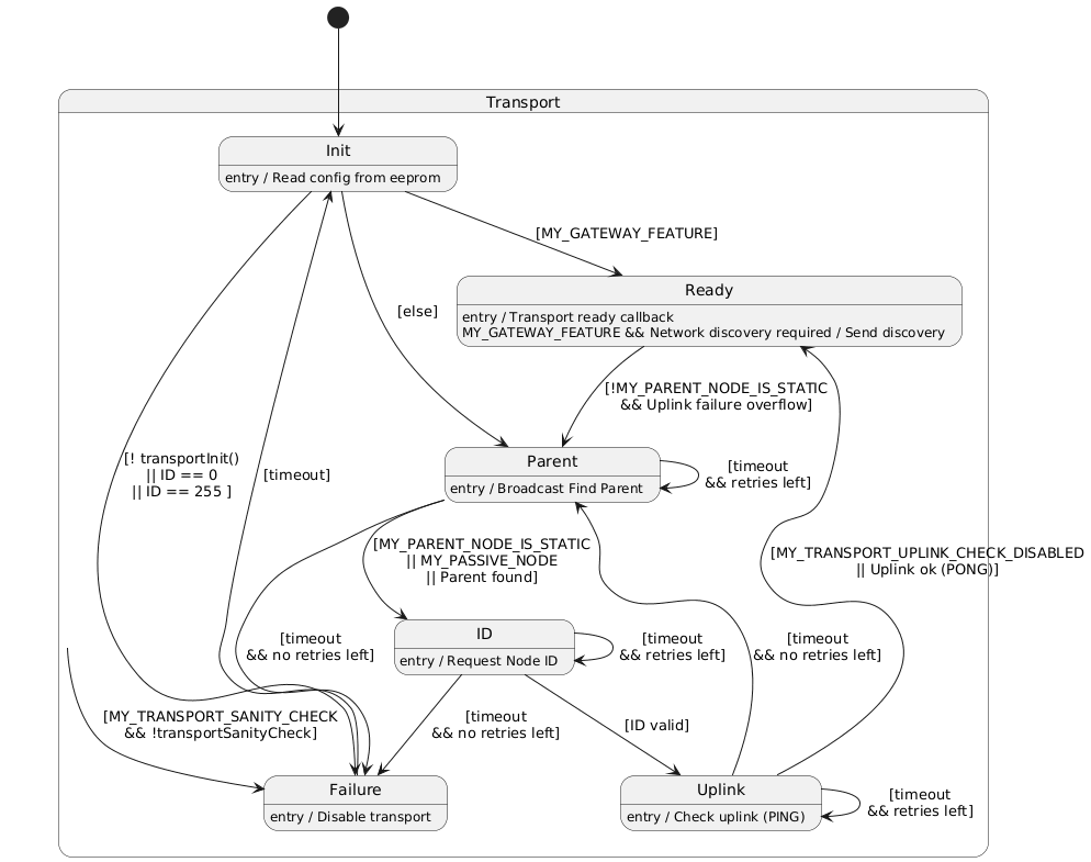

+ Collaboration diagram for MyTransport:
API declaration for MyTransport.

TSM INIT Transition to stInit state
TSM INIT STATID=%d Node ID is static
TSM INIT TSP OK Transport device configured and fully operational
TSM INIT TSP PSM Transport passive mode set
TSM INIT GW MODE Node is set up as GW, thus omitting ID and findParent states
! TSM INIT TSP FAIL Transport device initialization failed
TSM FPAR Transition to stParent state
TSM FPAR STATP=%d Static parent set, skip finding parent
TSM FPAR OK Parent node identified
! TSM FPAR NO REPLY No potential parents replied to find parent request
! TSM FPAR FAIL Finding parent failed
TSM ID Transition to stID state
TSM ID OK,ID=%d Node ID is valid
TSM ID REQ Request node ID from controller
! TSM ID FAIL,ID=%d ID verification failed, ID invalid, no ID received from controller
TSM UPL Transition to stUplink state
TSM UPL OK Uplink OK, GW returned ping
TSF UPL DGWC,O=%d,N=%d Uplink check revealed changed network topology, old distance (O), new distance (N)
! TSM UPL FAIL Uplink check failed, i.e. GW could not be pinged
TSM READY SRT Save routing table
TSM READY ID=%d,PAR=%d,DIS=%d Transition to stReady Transport ready, node ID (ID), parent node ID (PAR), distance to GW (DIS)
! TSM READY UPL FAIL,SNP Too many failed uplink transmissions, search new parent
! TSM READY FAIL,STATP Too many failed uplink transmissions, static parent enforced
TSM FAIL CNT=%d Transition to stFailure state, consecutive failure counter (CNT)
TSM FAIL DIS Disable transport
TSM FAIL RE-INIT Attempt to re-initialize transport
