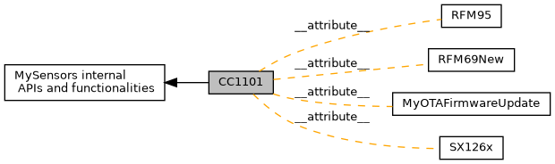

+ Collaboration diagram for CC1101:
API declaration for CC1101.
