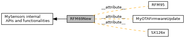

+ Collaboration diagram for RFM69New:
API declaration for RFM69.
