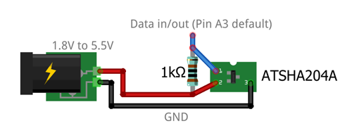

If you use hardware backed signing, then connect the device as follows:
Note
The pull-up resistor is optional but recommended.
If you change the default pin (A3) make sure you use a pin that supports input/output (e.g. A6 & A7 on a Pro Mini are input only pins).
