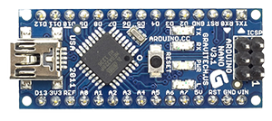

  - Easy and flexible- Nano is easy to program (USB connector is build in). It has both 5V and 3.3V output so you can hook up both radio and 5V sensors without fiddling with regulators. Power it from computer or any type of 5V USB wall-wart. Note: If you want to build an Arduino gateway for the Vera controller you will need one of these!

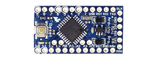

  - Cheap and flexible- Pro Mini 5V is great if you want to build super cheap sensors (nanos can be a bit pricey). - There is only one little problem with this module that need to be addressed and that is how to feed the radio with the correct 3.3V power. Luckily you can use a 5V to 3.3V regulator. - Pro mini is missing USB connections. To be able to download programs to the module, you will also need a FTDI USB to TTL Serial Adapter.
  - Battery operated- Pro Mini 3.3V is great for battery operated sensors. - No regulator is needed for the radio, but if you are using sensors that requiring 5V (like PIR) you might also need a step-up regulator. - Like 5V version, you will also need a FTDI USB to TTL Serial Adapter. Make sure to run it in 3.3V mode!

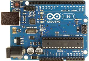

  - For prototyping- Uno R3 is bigger and it is much easier to reach all connectors. When testing and playing around we recommend to have one of these. There are also a lot of fun shields (add-ons) available for Uno R3.
