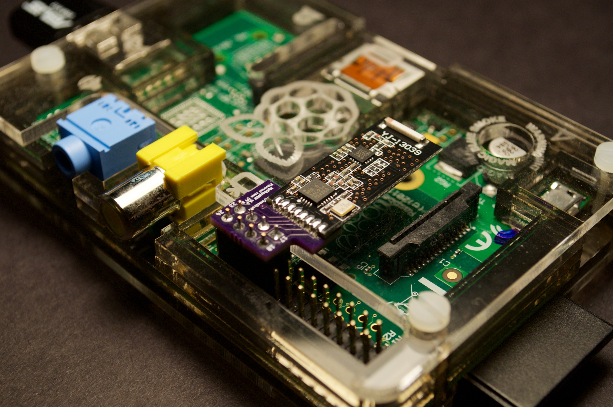

A Pimoroni version is also available, designed to fit inside the popular Pimoroni cases designed for the original Raspberry Pi model B, such as Pibow.
This version can be ordered directly assembled($20) on openhardware.io
