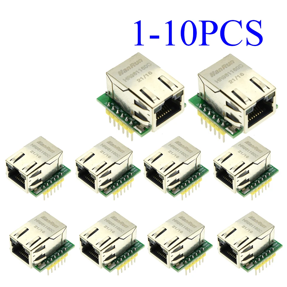

W5500 Ethernet module
Easy-to-use ethernet module
Unavailable   Buy
In stock - $4.40   Buy
