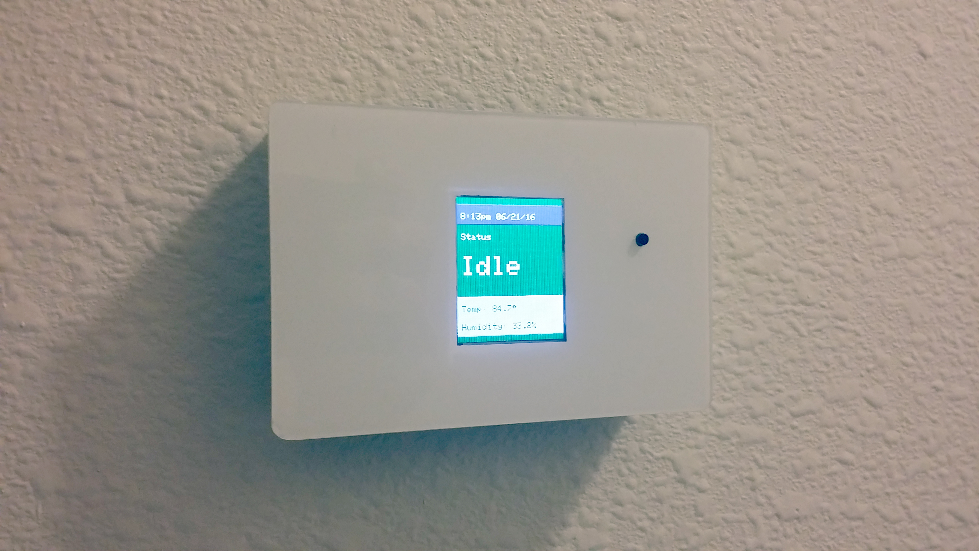

The LCD ![enter image description here](https://www.openhardware.io//uploads/57ac85f009fcb0930538262a/image/31 20160621_201413.jpg "LCD")
