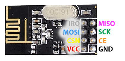

NRF24L01+ & Arduino
NOTE: The input pins on the NRF24L01+ is 5V tolerant. However, you cannot feed the module with more than 3.3V on VCC. If you use a 5V Arduino you have to use a step-down regulator!
Pro Mini / Nano Mega* NRF24L01+ Color
GND GND GND Black
5VReg -> 3.3V 3.3V VCC Red
9 49 CE Orange
10 53 CSN/CS Yellow
13 52 SCK Green
11 51 COPI/MOSI Blue
12 50 CIPO/MISO Violet
2 2 IRQ Gray
The IRQ pin is only required to be connected if the MY_RX_MESSAGE_BUFFER_FEATURE is defined in the sketch. Using this feature is recommended for high traffic nodes or gateways. Enabling it will result in better throughput but will require some additional memory to keep the message in memory before processing.
