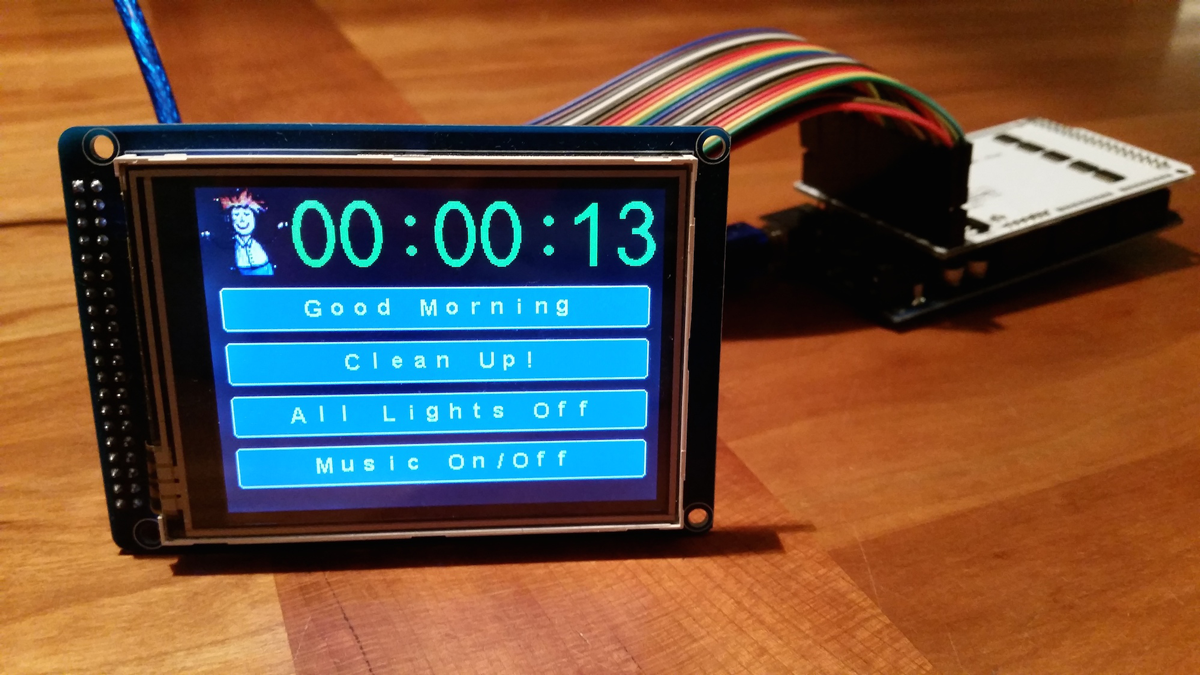

Sometimes you might want to control more advanced scenarios in your home automation project. This is when a scene controller comes in handy.
In this example we’ve used a touch screen to display the scene launch options. The buttons can be customized in the sketch code to your preference. With a little hacking you could even change button functions depending on the time of the day or create a full fledged menu system.
If you prefer to keep it simple you can skip the touch display and just attach a few buttons to your arduino to trigger the scene commands.
The provided example also displays the time in the top right corner. If you need more space for your buttons you can remove this part if you want.
The touch screen used here did not like to share SPI with the NRF24L01 radio. We had to move the radio to a separate software driven SPI interface. The wire instructions below show where to connect things.

This sensor mostly consists of the ATMega 2650, shield and display which is easy to snap together. The only thing left you need to connect is the radio. We choose to solder the wires onto the display shield but you might be able to temporarily connect the cables using dupont wires while testing. The 3v3 output of the ATMega2650 is a bit noisy so we choose to use a step down regulator from 5V->3v3 to smooth things out a bit (see buying guide below).
| AtMega 2650 Arduino | Step Down Module/Radio | | --- | --- | | GND | GND | | 5V | Step Down module VCC | | 14 | SCK | | 15 | MOSI | | 16 | MISO | | 17 | CE | | 18 | CSN |
