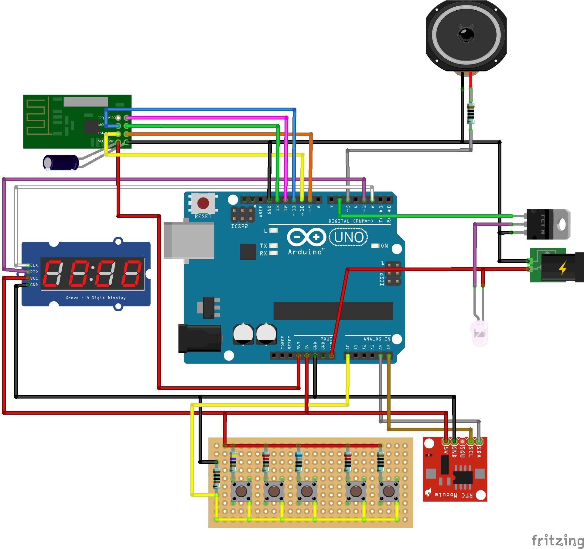

I always thought it would be cool to have a smart alarm clock, so I decided to build one for my kids rooms. I'm still working on this project, but I thought I would share it with the community.
I eventually plan on building it into some sort of cool case, like a toy t-rex or something.

History:
  • v0.0.2 === Small updates to functionality ( updated ClockRebuild.ino file )
Planned features:
  • Time Display | [DONE]
  • Time update from controller plus onboard RTC | [DONE]
  • Alarm | [DONE]
    • Set from controller | [DONE]
    • Set locally (using 3 buttons) | [IN-PROGRESS]
    • Turned on/off locally or remotely | [DONE]
    • Play music | [PART 1 DONE, PLAYS TONES. PART 2 WILL PLAY ACTUAL MUSIC]
    • Wake-up light | [DONE]
  • Night light (locally or remotely) | [DONE]
  • Bed Occupancy Sensor | [NOT STARTED] Source: https://www.openhardware.io/view/65/Bed-Occupancy-Sensor
  • Smart snooze | [NOT STARTED]
  • Control room lights | [NOT STARTED]
Example video of some of the functionality:
Wiring diagram (to-date) enter image description here
