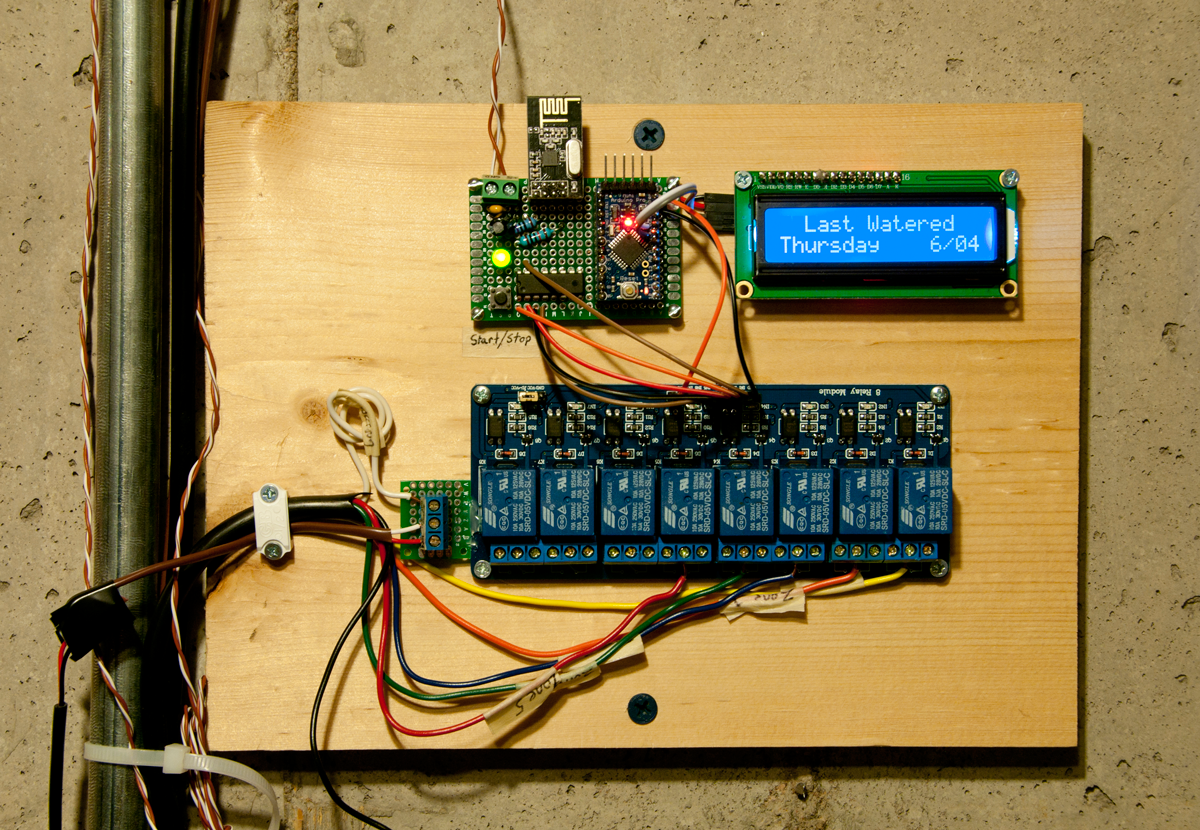

Tired of manually turning on the garden irrigation? Or want to smart-up that old "automatic" system which runs both on rainy and sunny days.
Now you can build your own MySensors-enabled irrigation controller. Wirelessly connect it to your smart home automation controller where you create the rules when it actually should run or not. Why not use a rain sensor to smart things up even more?
Big thanks to BulldogLowell and PeteWill for creating this amazing project. You can read the background story on the forum.

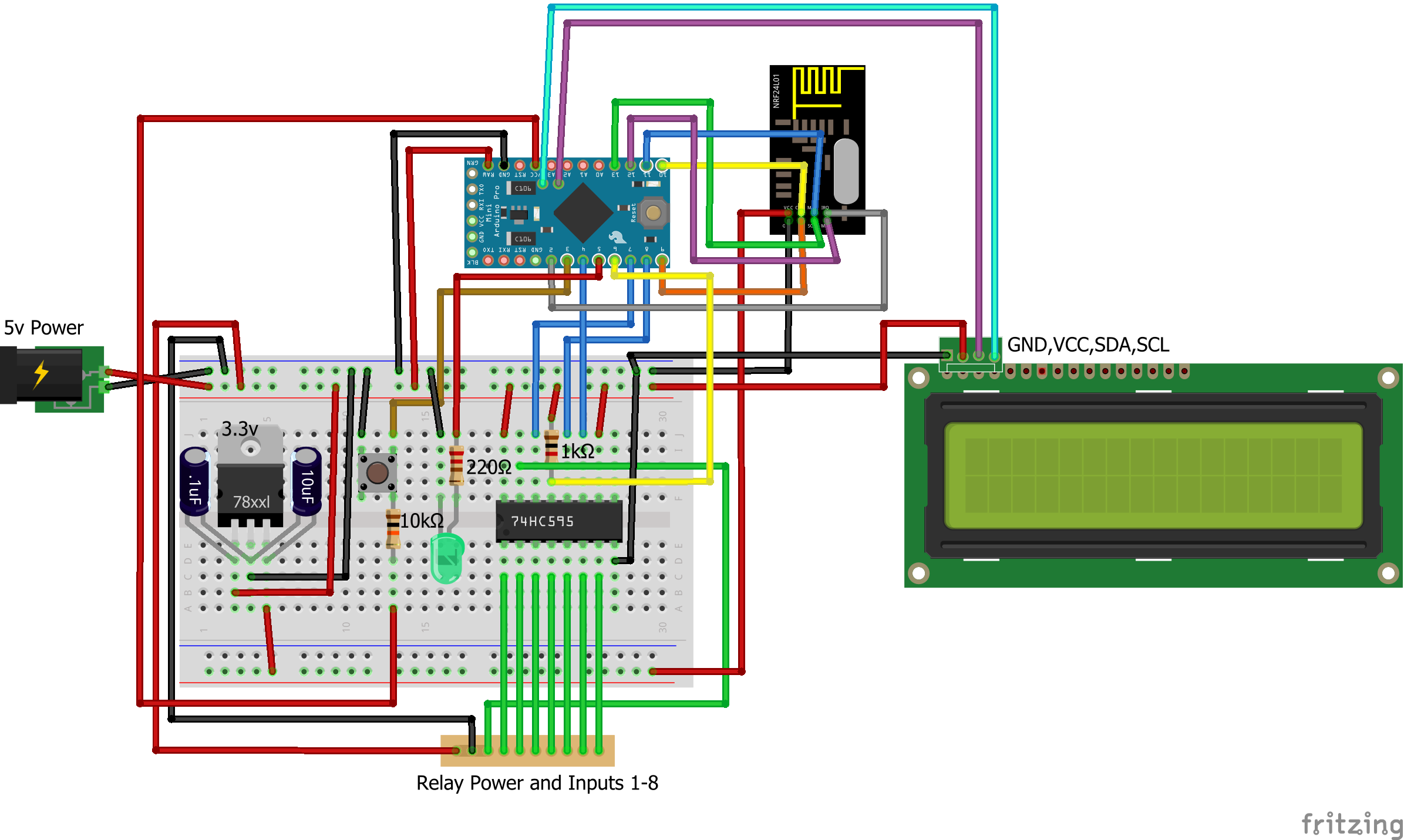

Wiring Things Up
Start by connecting the radio module. enter image description here

* Connect according to pinout below and uses Shift Registers as to allow the MySensors
  standard radio configuration and still leave available digital pins

* After assembling your arduino, radio, decoupling capacitors, shift register(s), status LED, pushbutton LCD (I2C connected to
  A4 and A5) and relays, and load the sketch.
* Following the instructions at https://MySensors.org include the device to your MySensors Gateway.
